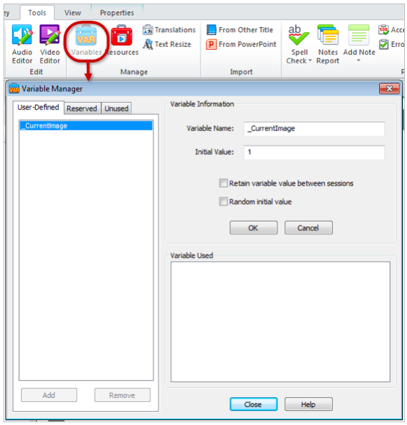

Making your own variables in Lectora is super easy. Open the Variable Manager from the Tools ribbon. The User-Defined tab is active by default. Click the Add button at the bottom of the tab. This creates a new variable and enables the Variable Information options on the right. By default, the new variable is named Variable1. But that’s not very descriptive, so you’ll want to change the name to something that describes what the variable will contain. Let’s call the variable _CurrentImage. (Tip: I like to start my variable names with an underscore so that they are placed at the top of the list in the Lectora variable selection menus.) Type that name into the Variable Name field. Now type the number 1 into the Initial Value field and click the OK button. TA-DA! You have magically created a new variable in which you can store a value and from which you can retrieve a value!
