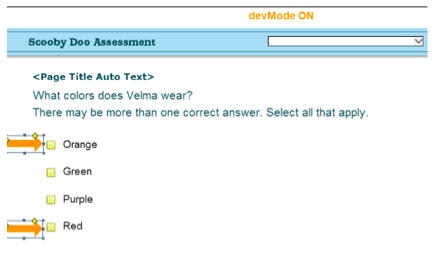

In essence, we activate the devMenu exactly like our devMode indicator: when you click the dev button, it turns on or off, and once it’s on, it stays on until you turn it off.The power to know all and see all (of the answers to quiz questions)When you are testing an online quiz with multiple questions, it can take time remembering all of the correct answers. Even if it only slows you down a second or two, it still takes time. But what if you could quickly see the answer? Better yet, if you need your SME to review your quiz to see if you have the correct answers coded, it can be much faster for them to see it onscreen than to read the feedback form at the end of the quiz.
This magic trick is simple: you just need to provide a visual indicator that identifies the correct answer(s) to the question. These indicators are hidden by default, but devMode causes them to appear! I prefer to use bright orange arrows as my indicators, though some questions like matching or drag and drop require me to get a little more creative. The principle remains… the visual answer indicators are hidden by default and only show up in devMode.How to add a magic answer keyFor the purpose of this exercise, I will use a multiple response question with 2 correct answers as my example.Up to now, everything we have done with devMode has been inherited throughout the course. With the answer key, the answers will change on every question page, so this process requires a little more manual work.
For example, add 2 orange right facing arrows.
Why are we adding a group? Some questions may have multiple visual indicators. Instead of having to show them each one by one, if you put them in a group, you only need to show the group.
Finally, we need a way to trigger these answers to appear.
In English, what we have programmed is as follows:
“When this Page loads, show the answers group IF devMode is turned on. Otherwise, do nothing.”
Copy the group and action to additional pages as necessary Although you will have to manually add the visual indicators and the page action to every page where you want answers to appear, you can simply copy and paste. Since the page action refers to the answers group, you can add items to the group or take them away without changing the action.
