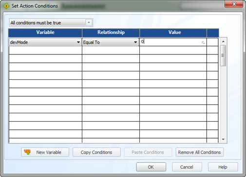

The Set Action Conditions dialog box is displayed.
What we are saying is that IF devMode is OFF (0), then run the action. The action, of course, will be to turn it ON (1).

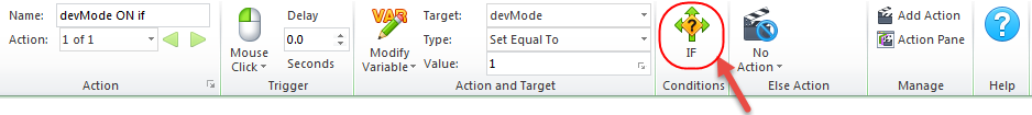

Click OK to close the Set Action Conditions dialog box.
The Conditions button now displays IF (instead of Always) because you have made this action conditional.

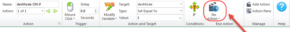

The final step is to specify what happens when our IF condition (devMode = 0) is NOT in effect. The only way our condition can’t be met is if devMode is already ON (devMode=1). In that case, the action we want is to turn devMode OFF (change devMode = 0).
Now your button turns devMode on AND off. Make sense? Feel free to test it out… the only problem is that devMode doesn’t DO anything just yet, so you won’t see any difference.This is plenty for today. In part 3 of this Downright Sneaky Lectora Tricks tutorial, we’ll add a devMode indicator to make sure it’s working.Download the Lectora and Lectora Online files for this course in the Trivantis® Community.John Mortenson is the Online Learning Manager for The Fresh Market. He has been developing online courses for over 10 years and is a member of the Lectora Advisory Board. He is also an Adobe Creative Suite Guru and cartoonist. You can contact him onLinkedIn andTwitter.
