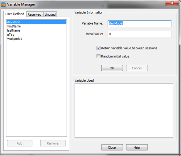

1. On the Tools ribbon, click Variables to display the Variable Manager dialog box.
2. Add a new variable and name it devMode and enter the following settings:
In the Initial Value field, enter 0.
That means devMode is turned OFF (0) by default.
Ensure that Random Initial Value is not selected.
If we set this value to random, occasionally it might be 1. We don’t want that.
Select the Retain variable between sessions checkbox.
This option means if I turn devMode ON (1) and exit the course, when I reopen the course, devMode will still be ON because it “remembers” how I left it. It is optional to select this (but I like to).
3. Click OK and click Close to close the Variable Manager window.
